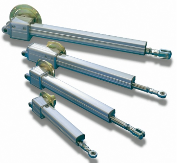

It appears SKF still produces the line of linear actuators but these are not a common failure item so make sure it has failed.
You can search Brian's alternate actuator for the Legacy in that forum. They need to move but the limits are governed by the limit switches in the original design. Another style will work using the existing limiting circuits but I do not recommend anyone change the circuits on the Lancairs because it is tested and incorporates limiting and braking. Let us know if you find anything or if you can identify the failure mode if you have one.
