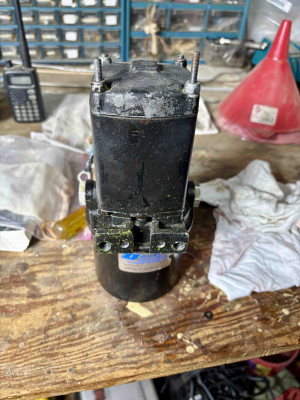

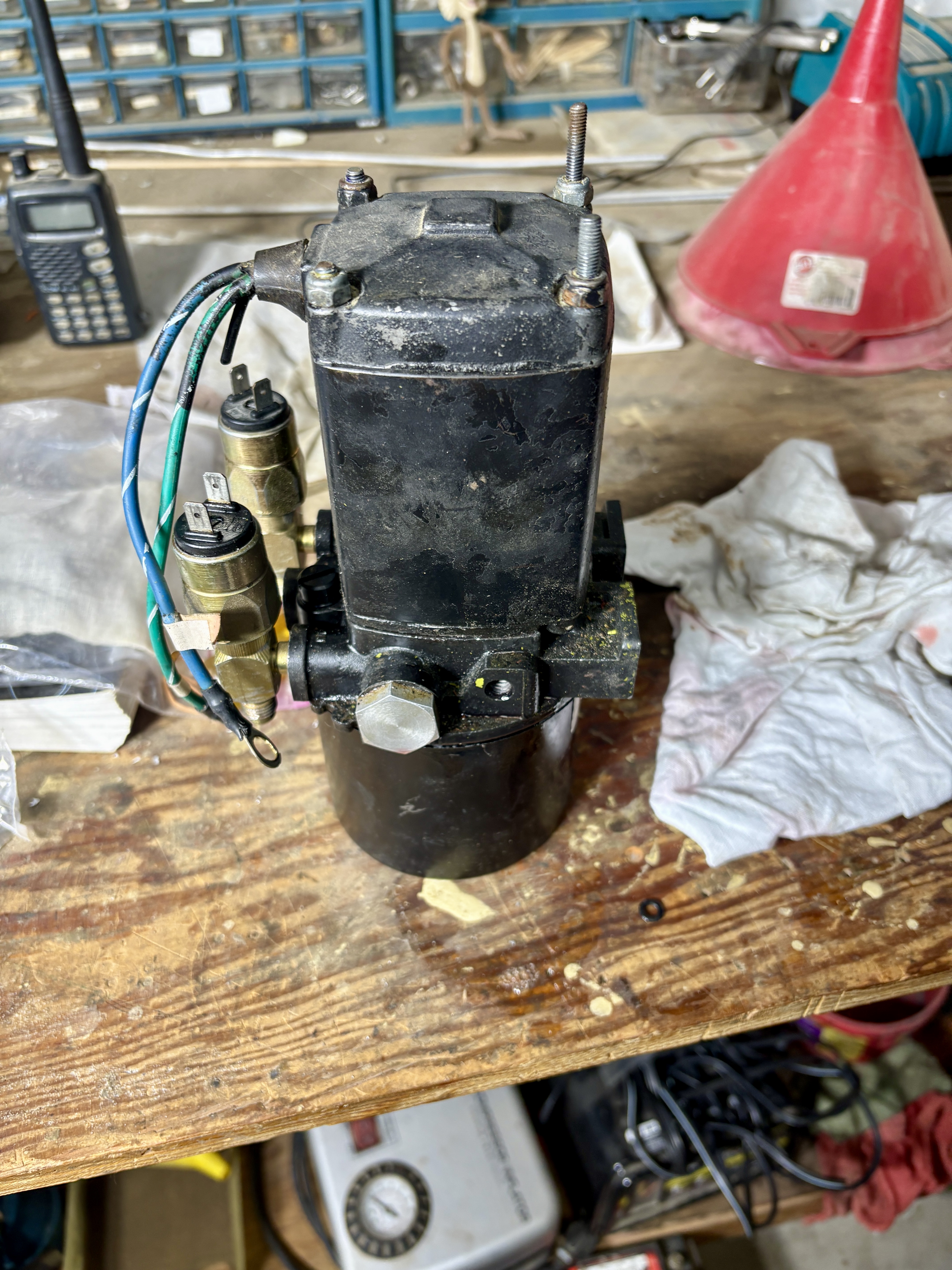

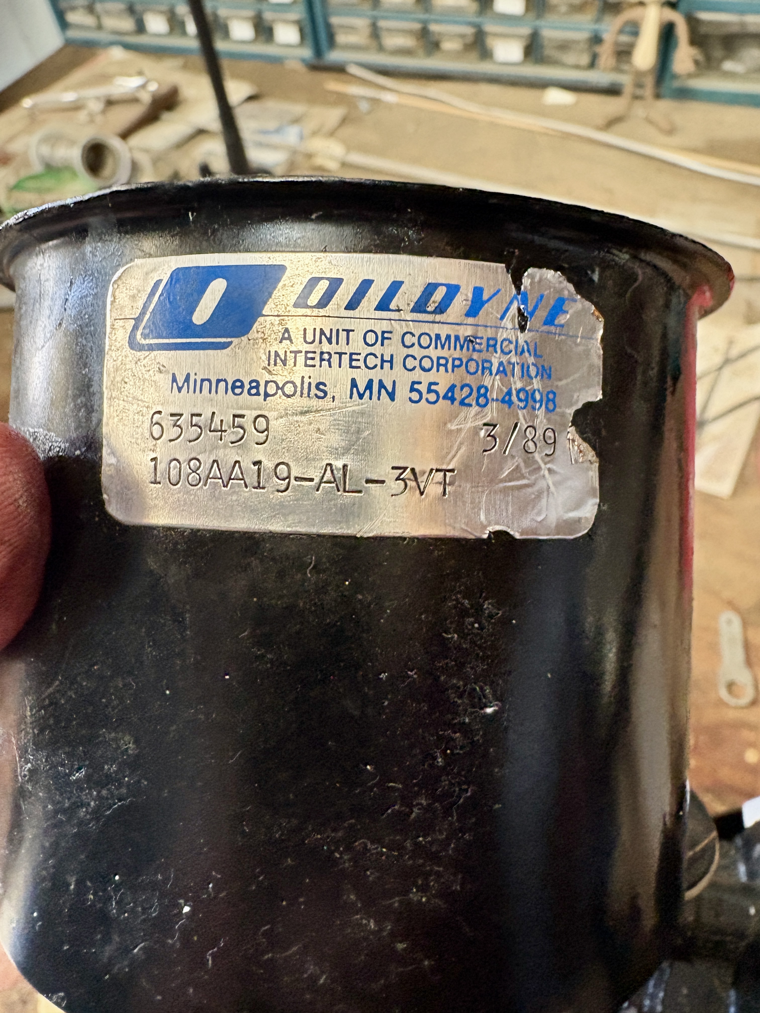

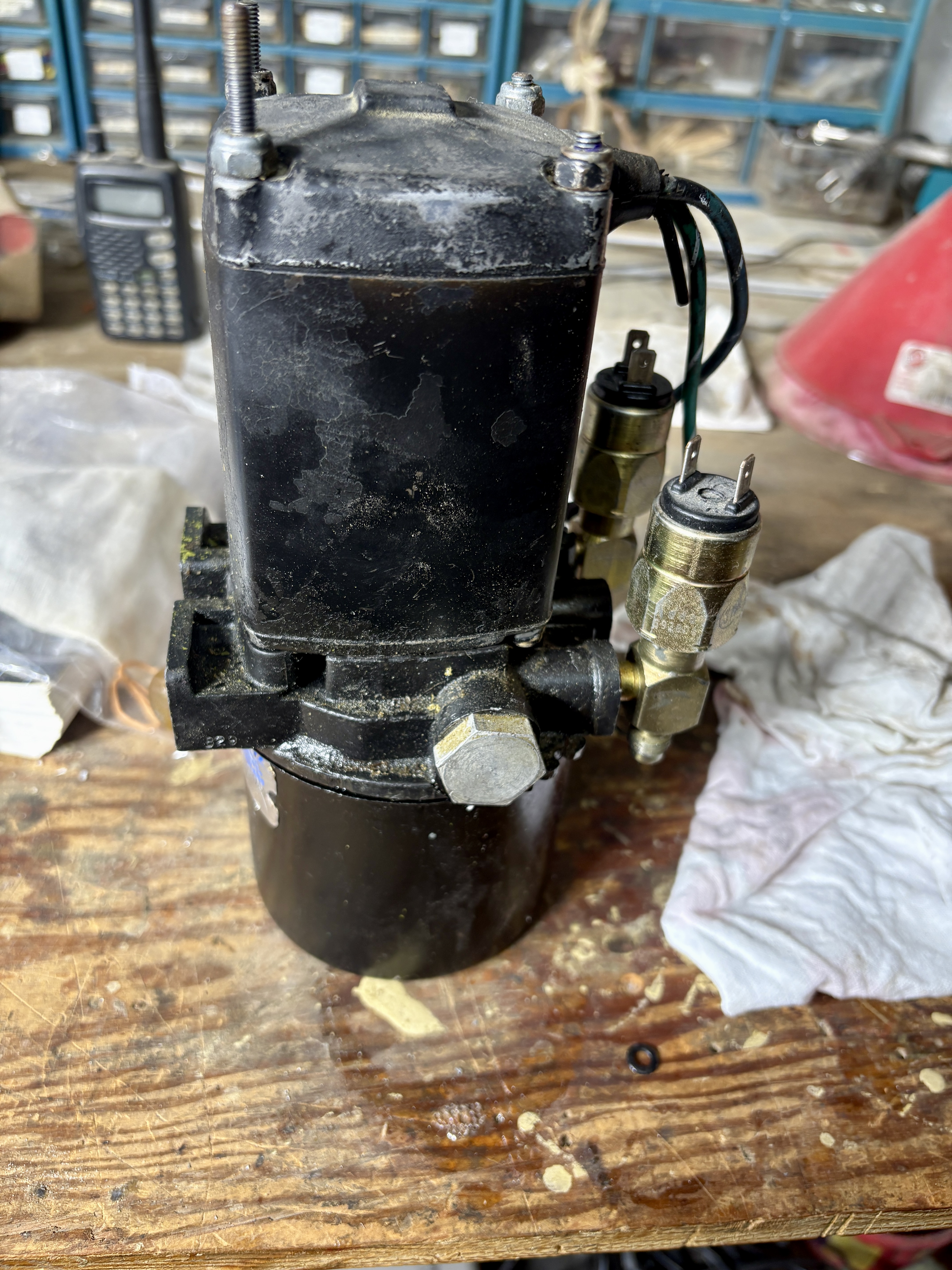

On my annual condition inspection, the pump suddenly stopped pumping fluid. It was if the bypass valve was open, but it was closed. The motor runs, but that's it. I've attached some photos. I assume you don't want the plumbing when I ship it to you.
Part Number
Side View
View of Bulkhead Side
Side View
